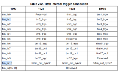

however after i compile and download the code there is no output. I read the RM0440 and on page 1081 there is a table 252. I am not sure i understand the table.
I am saying that i dont understand the table since i choose TIM8 in Trigger Mode and ITR8 as trigger source. I looked on internet regarding "TIMx internal trigger connection" and they are a  bit different, much easier to understand than one in RM0440.
So for my configuration on NUCLEO-IHM03, using TIM8 CH1, CH2 and CH3 as output and CH4 as trigger (i assume) how should i read the table 252. What should be my trigger source?

i was wondering if someone can help me understand table 252 from RM0440
Thank you

According to me you can TIM8 for Ch1, Ch2, Ch3 and for trigger source you can use ITR1 which is tim2_trgo but only thing is you have to start the timer2 then you will get the PWM in my understanding.
Mirza-AECAuthor
October 26, 2023
Hello
thank you very much for the response. I did as you have mentioned.
If you could maybe just write few words how did you come to this conclusion. For example what is first column TIMx? And how did you chose timer2? I imagine that is TIM2? Could you elaborate a bit?
