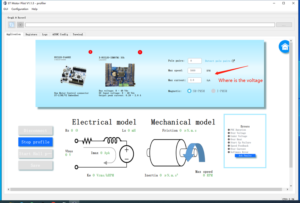

Hello @gtop.1​
The text field of the Vbus present on the old profiler is just indicative, it has no impact on the the proper functioning of the profiler.
It is used to indicate to the user that the Vbus entered is correct or not.

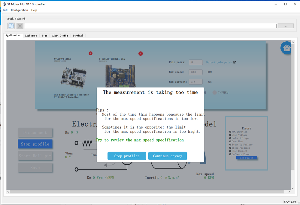

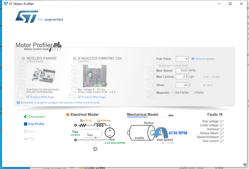

1.I use the profiler in mcsdk 6.1.0,but it says timeout.
2.Then I try profiler in mcsdk 5.Y.4 to check my hardware, it work well.
I want to ask mcsdk 6.1.0 whether it is Incomplete?
‎2023-02-03 1:00 AM
Hello @gtop.1​ ,
This message simply tells you that the profiling takes time, not that it has failed, you can click on the "Continue anyway" button and follow the profiling by the progress bar at the bottom of the profiler.
The old profiler also shows this message, if the profiling takes a long time, but the delays for its display are a bit longer.
and as the message indicates, if you increase or decrease the max speed according to your motor, the profiling could be done more quickly.
