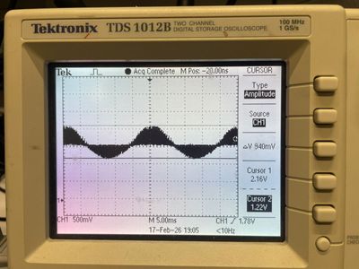

Update:
I've increased the shunt resistors to 1.2 Ohm, which is definitely on the large side, but the voltage should still be within limits. See attached the opamp output waveform. The sinusoidal waveform can surely now be observed, but unfortunately this did not solve the problem. I've also opted to opening the standard motor pilot window and playing around with the startup parameters and gain tuning, with no luck.
