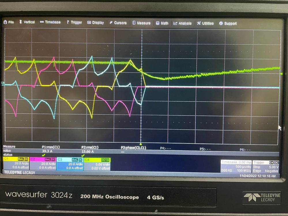

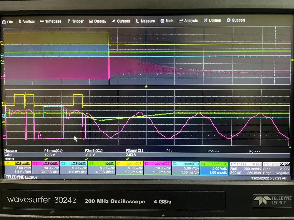

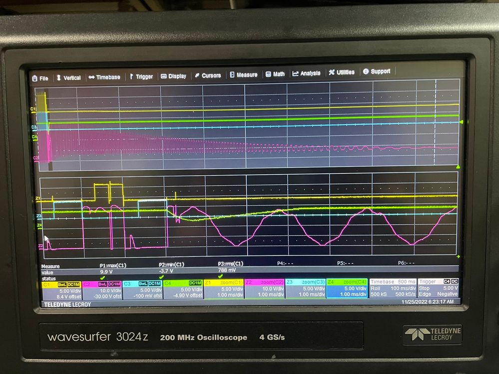

I use Internal comparator trigger Timer etr function to impelement cycle-by-cycle current mode control. I got uvlo protection when motor at heavy load(~40A pk).But when i use voltage control ,it would not occur. Does any one occur this problem?
GHSU-OUTU(yellow),OUTU(red),GLSU(blue),Buck VCC(green)
0693W00000WJaakQAD.jpgGHSV-OUTV(yellow),OUTV(red),GLSV(blue),Buck VCC(green)0693W00000WJaaaQAD.jpgPhase Current0693W00000WJaaLQAT.jpg
