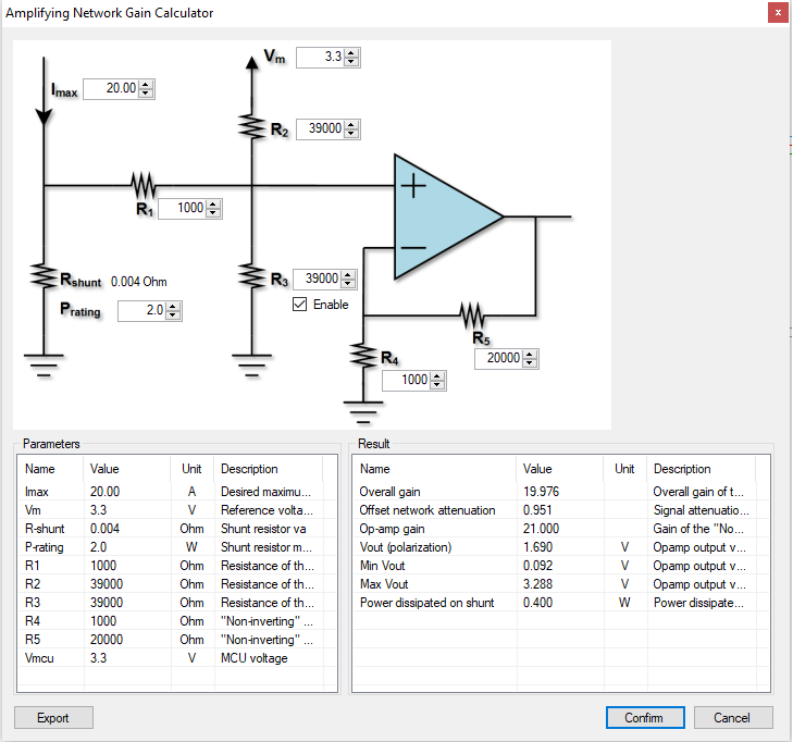

- Current Amplification changed (attached)

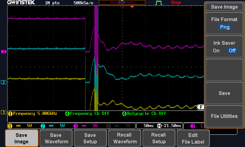

I scoped all three high side gate terminals of the Mosfets and I saw this:
There is an initial push and then nothing.
Can someone please tell me what could be going wrong?
