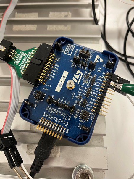

Hello and thanks for you answer. The ST-link is external and is a V3, connected to the target via a ARM20-CTX 20-Pin to TC2030-IDC Adapter and a segger TC2030 cable.0693W00000WLA0pQAH.pngI already ruled out a possibly bad connection by soldering the wires directly to the target - no change.

Could you reduce the wire length between ST-link UART and your board? I see some wire connect to another cable. You cannot achieve a stable communication @1.8Mbaud which such long wire. Please don't exceed few centimeters. ( I have faced issue with 10 cm).

thank you, I reduced the wire length to the minimum for me possible, about 3 cm. Still no improvement unfortunately. I reduced the baudrate to 115200 in combination with the short wires, now its a bit better with less often connection cuts, but still far away from stable.
