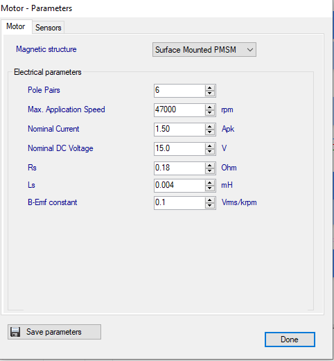

I went back and created a conservative motor profile for the EMAX 1106/6000 from values measured independently to:
0693W00000WKvNUQA1.pngGenerated code. Compiled it in STM32CubeIde and uploaded it into the board.

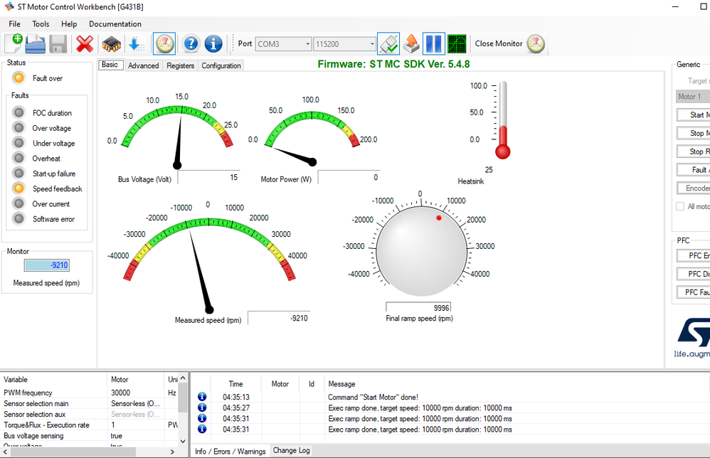

Back in the motor work bench, connect to the board and run Start Motor - the motor moves slightly and starts.

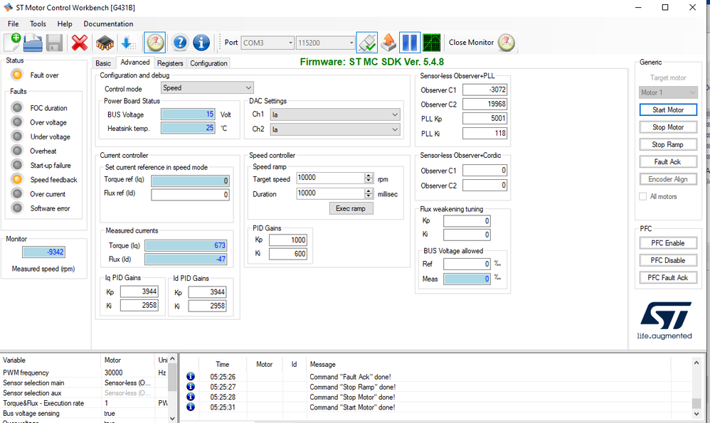

In the advanced tab - set the Speed controller to 10000rpm and 10000ms. Press Exec ramp - nothing happens - the motor does not run. Note there looks to be a speed feedback in orange warning - why?
0693W00000WKvPGQA1.pngAny ideas?
I am running my power supply at its maximum 15v - do I need "3s" (21v~)? The motor is a 2s/3s motor, does the board needs this level of voltage?
Please please improve your documentation. Start with a simple diagram that describes the workflow. Provide more info about errors. Fix the UI. It took me a while to even find the Exec ramp.
What would you do if you were me to get this to work?

I set the "Nominal dc voltage" to 8v. and reran. The motor tries very hard to run after start motor. After a couple of secs this appears - Speed feedback
What does this mean?

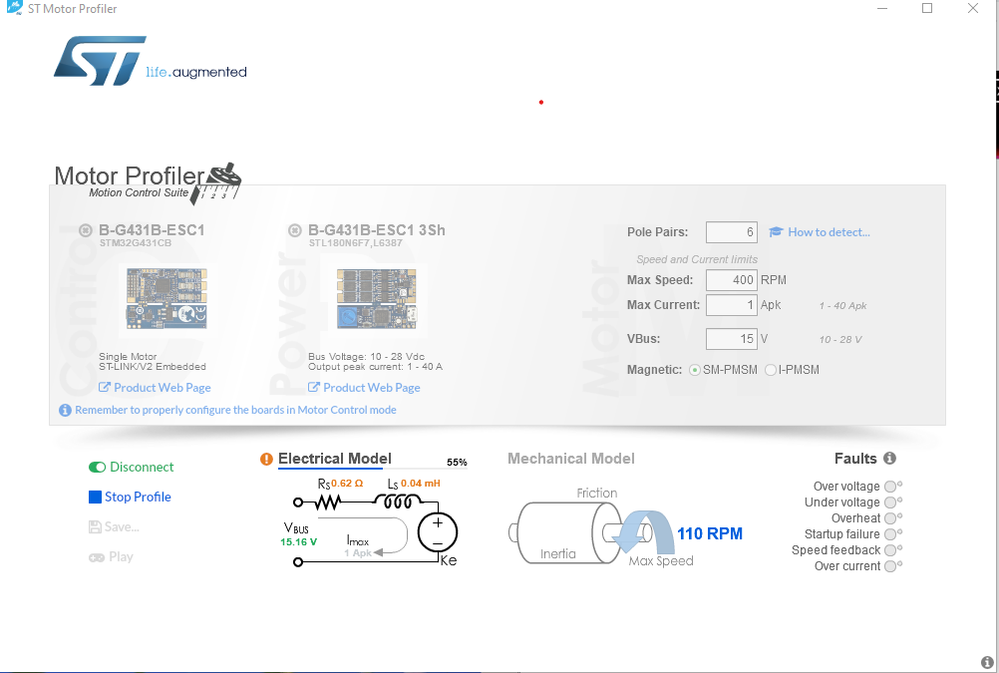

More to report - first motor profiling.
I grabbed another 1106 emax drone motor (4800 kva) that has a slightly higher impedance than the other one and grabbed a 5amp psu. I made sure I updated to the 5.4.8 and 6.1.0 mcwb.

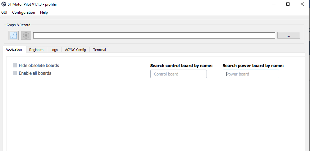

The 6.1.0 wb's profiler (ST Motor Pilot V1.1.3) is a step backwards - there seems to be no way to find the board and it's unclear what needs to be typed into the search fields to find something - more about the 6.1 wb in min ...
The 5.4.8 wb profiler mostly works. Setting as follows:
pp: 6
rpm: 1000000 (yes that high)
Apk: 2.7
VBus: 12
It seems to hit the motor with the full amount of current (and makes it very warm) and reports .8 ohms and .03 mH, and then runs it up. It reaches about 33,000 rpm consuming about 1.3 amps, at some high percentage complete and then seems to reverse the motor and do it all again before stopping at 96%-ish complete and complains about taking too long. Answering the prompt to continue restarts the cycle running the motor at 40% - it never completes whatever changes are made. ARGH
Is this a bug? Can the timeout a set bit higher? Is the rpm max value being scaled by 100? (The only way to get to 30000 is by making this value enormous)

After repeating profiling tests with both the 5.4.8 and 5.Y.4 mcwb's (no luck with 6.1.0 since there is no board support that I can tell) I believe the associated profilers behave the same way and have similar issues (at least when trying to profile my motor).
The 5.4.8 wb reports:
MCSDK_v5.4.8
WB_to_Mx version "1.5.1"
WB_to_Mx.template version "21-11-15"
[Device]
Device not connected
[Modules]
MMICalc DLL - Version 1.0.4.0
 Basic Motor Control Serial Protocolo Library  - Version 3.3.0.0
TL_003 Frame Transport Layer - Version 1, 0, 0, 0
PL_001 Dynamic Link Library - Version 1, 1, 10, 0
and the 5.Y.4
MCSDK_v5.Y.4-Full
WB_to_Mx version "1.6.0"
WB_to_Mx.template version "22-01-11"
[Device]
[Modules]
Despite setting extremely high (eg 100000) Max Speed values in the ui (and setting 2 amp, 12.3v, in the ui; with a 5 amp psu providing 12.4v) ) the motor will (after pulsing with 2amps and reporting back values in the range .58-.8 amp, 0.02-.0.05 mH) never exceed 32490 rpm despite being rated at 4800 kva. Once reaching this speed the motor reverses, and reaches 4800 and then throws a warning prompt: The measurement is taking too time
If I set the max speed rpm to 10 times the max rpm max value for a value below 32490 e.g. 160000 it reaches the corresponding speed by a lower factor of 10 i.e. 16000.
The test behaves the same way repeatedly.
Are these defects in the profiler code?
