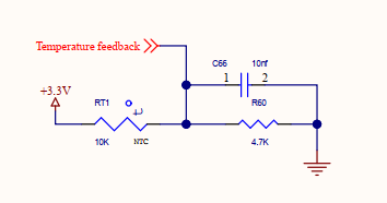

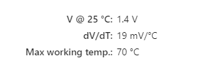

Hi i am using B-G431B-ESC1 Discovery kit with STM32G431CB MCU, i had doubt on the temperature sensor, I have seen the schematics the calculation shall be at 25DegC = 3.3*4.7/(14.7) = 1.05, but the workbench shows 1.4V, why? Please advise.
