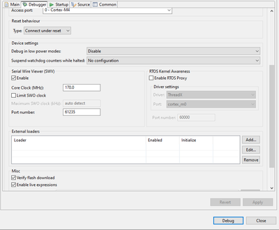

Hello STM32 Community,
I am currently working with the STM32 MotorControl Workbench framework, specifically using the EVSPIN32G4 demo board. For development, I'm utilizing the STM32CubeMX and STM32CubeIDE tools.
My issue lies with debugging. I'm attempting to use printf statements for debugging purposes through the ITM (Instrumentation Trace Macrocell) debugger interface. However, this is not working as expected. The printf messages are not being displayed.
I'm wondering if anyone can shed light on why this might be happening. Are there specific settings or configurations within STM32CubeMX or STM32CubeIDE that I need to adjust to enable ITM debugging correctly?
Additionally, I'm open to suggestions for alternative methods to output debug messages effectively in this setup. Any insights or experiences shared would be greatly appreciated!
Thank you in advance for your help and support.

See attached document (it is in dutch, but the images should be point into a direction).

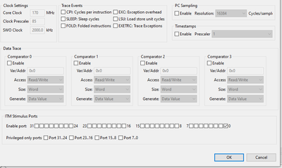

kaps
Hello again,
Thank you so much for your response and suggestions. Unfortunately, I'm still facing the same issue where the ITM debugging is not functioning correctly with the STM32 MotorControl Workbench.
I've attached images showing my current settings to give you a better understanding of my setup. Interestingly, when I use the project without the STM32 MotorControl Workbench, the ITM debug messages work perfectly. It's only when I integrate the STM32 MotorControl Workbench that I encounter this problem.
Could there be a compatibility issue between the MotorControl Workbench and ITM debugging? Or perhaps there's a specific setting within the Workbench that needs to be configured for ITM?
Any further assistance or insights would be greatly appreciated, as this issue is proving to be quite perplexing.

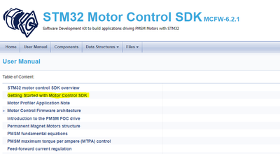

If you have never used the Motor control Pilot, then I strongly advise you to have a look at the following documentation:
I you use the MCSDK 6.2.1 to generate your project, and are able to connect the MC Pilot to your board, then you can have a quick look at the following page:  https://wiki.st.com/stm32mcu/wiki/STM32MotorControl:STM32_MC_Motor_Pilot_-_Start-up_guide#Viewing_and_plotting_registers_with_high-speed_plotting

Please try a minimal ITM_SendChar test, immediately after the programs sets the MCU core clock  - before touching  other peripherals, calling any other libraries...
kaps
I have performed the test as you described, ensuring that the ITM_SendChar function is executed right after setting the core clock. Unfortunately, I must report that the issue persists, and I am still unable to output messages using ITM.
