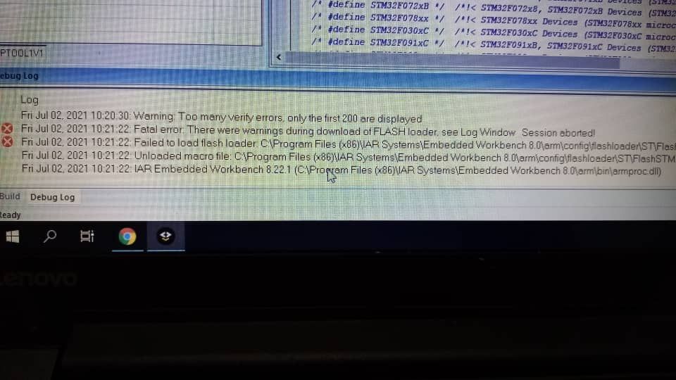

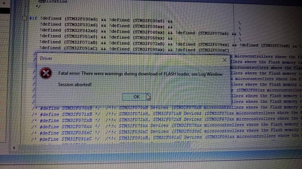

i downloaded the firmware package that u sent. issues were fixed and .hex file was made.i have new issue and can not resolve that.
IAR IDE generates a message error during download and debug progress."fatal error:there were warnings during download of flash loader,see log window session aborted:"
it would be appreciated if guide me more!

i have been tested "connect during reset" mode in IAR IDE and ST-LINK Utility software but my problem was not resolved.my debug log pictures is following:0693W00000BchjnQAB.jpg0693W00000BchjiQAB.jpg thanks and best regards cristina

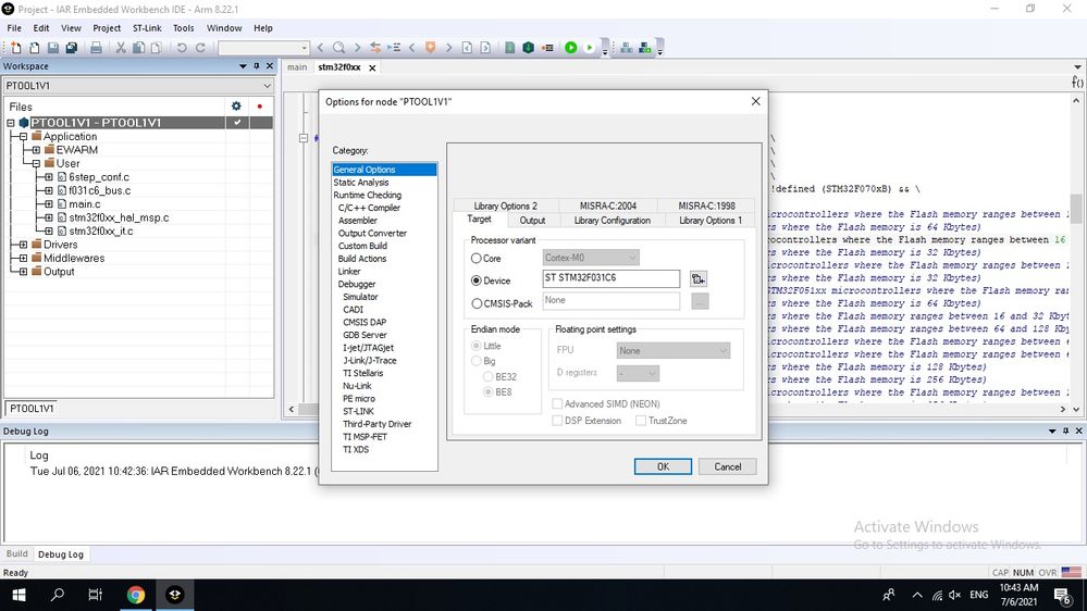

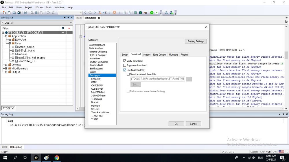

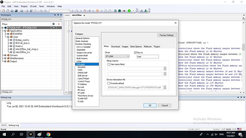

could you check and share (screenshots are ok) your project configuration?
  • General options -> Target
  • Debugger -> Setup
  • Debugger -> Download

hello cristina
screenshots are following:
0693W00000BcytLQAR.jpg0693W00000BcyuJQAR.jpg0693W00000BcyuYQAR.jpgthanks and best regards
