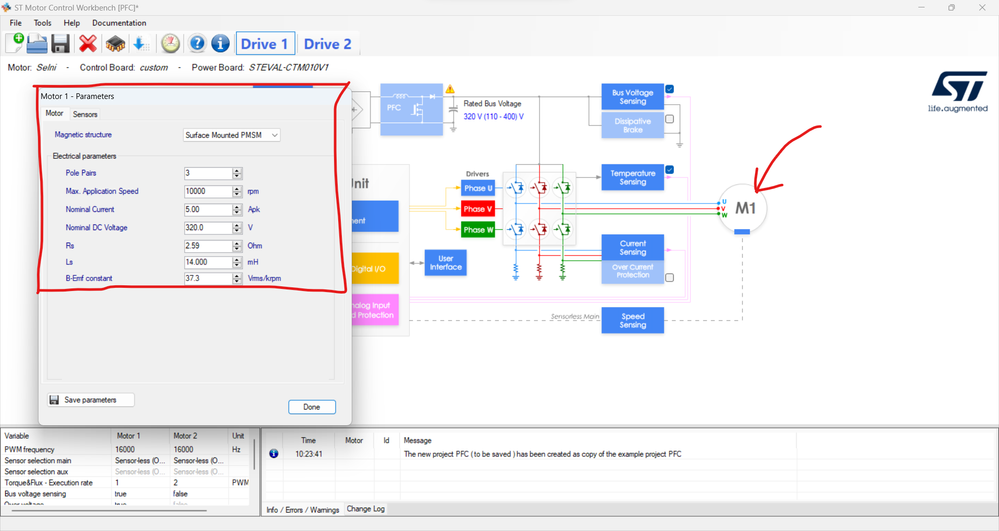

Hi Gaël A
Thank you very much for your insightful reply.
Could you please tell me further:
  1. The data generated after pressing Start Profile button in the Profiler tool (inertia, friction, current etc.) is "No-Load Data" or "With-load/On-Load Data"?
  2. If I click on the Motor Block in the WB tool, I get this list of parameters to be entered:
    Can I enter these parameters manually (and skip the profiler tool part)? I can source these parameters from the Motor Datasheet/specification-sheet.
    Would this be sufficient or still there is something else that only Motor Profiler tool can provide and I can't.
  3. Even if I put in the Motor data manually, without using the profiler tool (as I said in point 2), would that impact my application/code/resulting system?
Actually I have the STEVAL-CTM010V1 kit with me but looking at the current scenario, I want to make sure whether there is any workaround (related to profiler) or not before I order a new kit to get my work done.
Thanks
Manish Verma
Hello ManishVerma,
If you want to bypass the Profiler Tool step, I advise you to create a .xml file by taking examples on other referenced motors and then fill in all the needed values. Your motor will then appear in the WB as a referenced motor. This way, anytime you want to create a project using you motor, you won't need to manually enter its characteristics through the WB UI.
