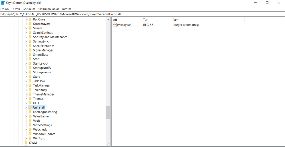

- can you tell me if you are installing CubeMx with your admin account or not?
- can you check if when editing windows "register editor" in the following path Computer\HKEY_CURRENT_USER\Software\Microsoft\Windows\CurrentVersion\Uninstall you have the Key for your installation of Cube Mx ()

ilker07

@ilker07 ,
your register key status explains that the MC Workbench cannot detect whether a CubeMx version is installed or not.
Can you check also this key in the following path :  Computer\HKEY_LOCAL_MACHINE\SOFTWARE\Microsoft\Windows\CurrentVersion\Uninstall\STM32CubeMX

ilker07
there is no folder named STM32CubeMX after  Uninstall.

@ilker07 ,
ok all this explain your problematic because the detection of CubeMx version through MC WB GUI is based on those windows keys, and the only way to solve it is to again, sorry but we need to do so again, is to
- uninstall and reinstall STM32CubeMx v6.2.0 or you can use also 6.4.0 which is compatible with MCSDK 5.4.8
- do it with admin rights and select whether you want it to be for you only or all users on the machine.
By the way, do you select the path where to install CubeMx or do you let the default path ?
