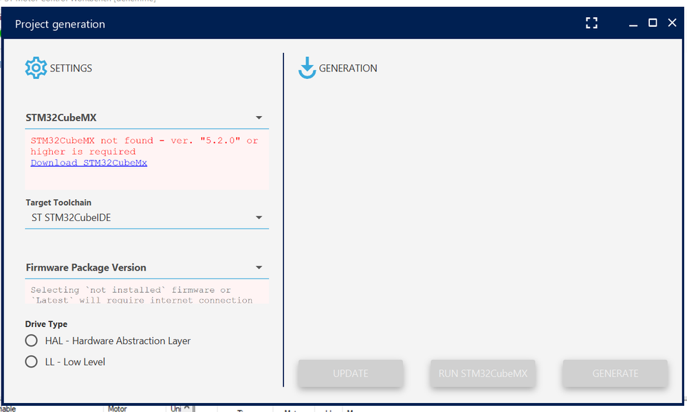

Hi everyone,I have problem about ST Motor Control Workbench.I can ' t generate project.I tried so many things(I installed and unistalled different versions , I changed OS language etc.) but I couldn't do it .Please help.stPic.PNG

@ilker07 ,
it seems that the STMC Workbench does not detect correctly the latest version of CubeMx installed.
Can we try to uninstall the Cubemx and reinstall it, and try again please (keeping MCSDKalready installed)?

@ilker07 ,
your register key status explains that the MC Workbench cannot detect whether a CubeMx version is installed or not.
Can you check also this key in the following path :  Computer\HKEY_LOCAL_MACHINE\SOFTWARE\Microsoft\Windows\CurrentVersion\Uninstall\STM32CubeMX

@ilker07 ,
ok all this explain your problematic because the detection of CubeMx version through MC WB GUI is based on those windows keys, and the only way to solve it is to again, sorry but we need to do so again, is to
- uninstall and reinstall STM32CubeMx v6.2.0 or you can use also 6.4.0 which is compatible with MCSDK 5.4.8
