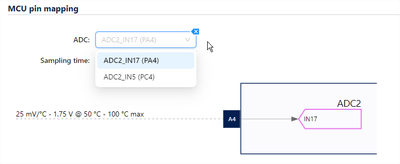

Firstly, we would like to sincerely apologize for the delay in replying to your post.
If your point is still pertinent, please consider using MCSDK6.2 WorkBench, you will be able to directly edit a board description .json file (starting from an existing one using STMC Board Manager) in order to add your new temperature measurement input as below:
"TEMPERATURE_NTC": [
    "name": "PC4",
    "help": "",
    "cost": 0
    "name": "PA4",
    "help": "",
    "cost": 0
Starting a new project with this modified board description, motor control workbench will give you the input choice and will generate the project accordingly.
If you agree with the answer, please accept it by clicking on 'Accept as solution'.
Best regards.
