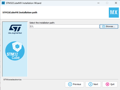

I'm in charge of the motor driver for a new project we've started working on. I freshly installed MotorControl Workbench, CubeMX and the IDE. After setting all parameters in Workbench and hitting "Generate the project" button I get a Java runtime Exception "unkown protocol c". I've hit a wall trying to fix this as there's almost no info about similar issues on the web.
I tried uninstalling and installing different versions, too.
Using windows 11 pro, 24H2.
Any suggestions what might go wrong here? I've tried installing the oracle JDK and using that instead of the openJDK runtime but I couldn't get Workbench to use it (this was the only info I could find).
Thanks for any help on this!

The STM32CubeMX 6.16 tool is available here.
As you mentioned, try selecting a path without special characters.

Just to follow up here: we eventually changed the username removing "special" characters (é in my case) in the home-directory path, this did the trick.
