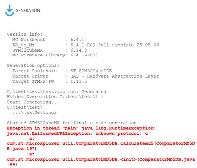

I'm in charge of the motor driver for a new project we've started working on. I freshly installed MotorControl Workbench, CubeMX and the IDE. After setting all parameters in Workbench and hitting "Generate the project" button I get a Java runtime Exception "unkown protocol c". I've hit a wall trying to fix this as there's almost no info about similar issues on the web.
I tried uninstalling and installing different versions, too.
Using windows 11 pro, 24H2.
Any suggestions what might go wrong here? I've tried installing the oracle JDK and using that instead of the openJDK runtime but I couldn't get Workbench to use it (this was the only info I could find).
Thanks for any help on this!
So I noticed that some other tools have issues too. Could it be the é ("special character") in the windows username (and subsequently in the home-directory path name) that causes issues with scripts and such?
Trying with IT to remove it but this will take some time. Any suggestions welcome

Unfortunately, it doesn't even reach that point. It fails right away, pretty much.

I uninstalled all previous versions of Workbench and MX and downloaded and installed the newest again. I also re-installed the FW package for the G431 and I'm STILL getting this error (see screenshot).
Edit: I also tried making new projects, choosing a predefined pack (everything stock from ST)

Hi @nb_coresight ,
this issue has been identified and should be fixed within next release of STM32CubeMx 6.16.0 which will be available in the coming weeks.
Nevertheless, can you please check with the version 6.14.0 and let us know your status.

Nope, still the same issue
