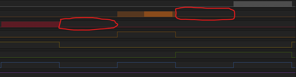

The problem i'm experiencing, is that between steps using the same "high-side" PWM, the output goes low after changing the low side - for example:
going from step 2 to step 3, the PWM is correctly genrated on CH3 during step 2, but the outpul stays in the low state during step 3.
0693W00000QNBFJQA5.pngFunny thing is if i do a breakpoint in the callback and use the debug as a "step mode" the pwm is generated properly. Maybe anybody experienced something similar in the past?

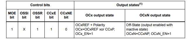

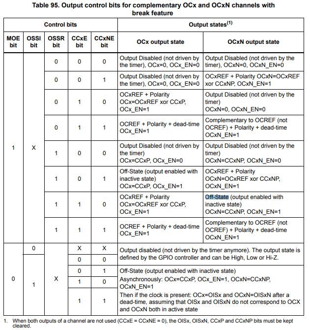

I got it to work - most of the issues were coming from turning off both the CCx and CCxN channels:
0693W00000QNSPTQA5.pngIf you set both to 0 (both OSSR and OSSI are '1' in my case), then both channels are no longer driven by timer - that caused issues when i just turned it back on. I opted for the option of disabling only CCxN and setting CCR registers to '0'.

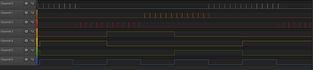

My final results:
  • Channel 0: CC1
  • Channel 1: CC2
  • Channel 2: CC3
  • Channel 3: CC1N
  • Channel 4: CC2N
  • Channel 5: CC3N
  • Channel 6: LED toggle at trigger event
I hope this will be able to help someone with similar issues in the future.

> Everything is set so that PWM preloaded registers update happens in a commutation event
Only the  CCxE, CCxNE, CCxP, CCxNP and OCxM bits are loaded upon COM event (if TIMx_CR2.CCPC is set). The TIMx_CCRx registers, if preloaded (OCxPE set), are not loaded upon COM event but upon Update event.
> TIM8->CCER = 0UL | ( TIM_CCER_CC3E | (TIM_CCER_CC1E) | (TIM_CCER_CC1E) )
This does not seem to be correct.

	htim8->Instance->CCER = 0UL | TIM_CCER_CC1E | TIM_CCER_CC2E | TIM_CCER_CC3E;
	__HAL_TIM_ENABLE_IT(htim8, TIM_IT_TRIGGER);

My final results:
  • Channel 0: CC1
  • Channel 1: CC2
  • Channel 2: CC3
  • Channel 3: CC1N
  • Channel 4: CC2N
  • Channel 5: CC3N
