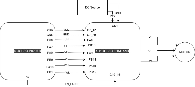

Hello everyone,
I'm currently working on driving a 24V, 1.5A BLDC motor using a Nucleo-F070RB board along with the X-NUCLEO-IHM16M1 motor driver shield. For testing purposes, I'm running the motor in open-loop mode.
I've configured Timer 1 to generate PWM with complementary signals. However, when I check the outputs with an oscilloscope, I don’t see any PWM signal. Additionally, the status LEDs (D8, D9, D10) on the driver board are not lighting up.
I've attached the connection diagram below for reference.
Has anyone faced a similar issue or have suggestions on what might be going wrong? Any help would be greatly appreciated!
Thanks in advance!
Best answer by snehasish1991
Hi @GMA
Turns out the issue was that I was mistakenly supplying complementary PWM signals to the ENU/ENV/ENW pins. Once I changed those pins to a constant HIGH level by configuring them as GPIO outputs, I started getting the expected PWM signals.
Thanks & Regards

Hello @snehasish1991,
Using MCSDK tool available here, you can generate a project with available NUCLEO-F072RB/X-NUCLEO-IHM16M1 board and have a look at Timer 1 settings (Parameter and GPIO settings).
If you agree with the answer, please accept it by clicking on 'Best answer'.Best regards.GMA

Hi @GMA
