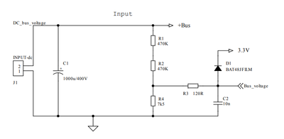

Lukas47
Hi, @Zied b.
Is there anything else than the bus voltage divider (126.33) that limits the voltage range to 125V? This divider would give a low SNR for lower voltages. But I can't find anything else in the schematics that would limit the voltage downwards? Also the IC does not specify any lower limit.
Hello @Lukas47,
The bus voltage divider ensures that the +3.3V ADC input is not exceeded for the DC bus voltage measurement.
You can use the STEVAL-IPM30B at voltages lower than 125V. This value ensures optimal power board performances.
If you agree with the answer, please accept it by clicking on 'Accept as solution'.
Best regards.
