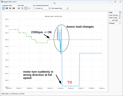

[DETAILS]: at heavy load step the motor turns suddenly in wrong direction with full speed (see plot below)
[EXPECTED BEHAVIOR]: stable speed or motor stops with speed feedback error or over current error

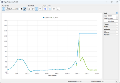

Could you plot the IQ_MEAS and IQ_REF during the error use case?
You can decrease the STO-PLL variance threshold to make the system more sensitive to incorrect speed estimation.

Attached you will find two plots showing IQ_MEAS and IQ_REF at the moment when the motor starts turning in the wrong direction.
I also tried reducing the variance threshold from 25% to 10%, but unfortunately, this did not resolve the issue.
However, I discovered that lowering the PLL Kp in the Observer from 250 to 120 makes the problem less severe or almost eliminates it. That said, this adjustment results in poor control at low speeds.
