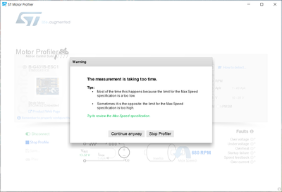

Motor Profiler Version 5 and 6 keeps saying it takes too long
hellouniverse
Hi ST Team,
Happy new year and I managed to connect and get the motor somewhat running! However, I am bumped into other issue.
Also, I kept getting the prompt of the testing takes too long, and it doesn't seem to generate a profile because it's not finished. The profiler doesn't seem to be content regardless of the range of input I set.
FYI : the input I gave -> Vsupply = 13V, Current Max = 5A, Max Speed = 17000, pole pair = 6
I'm trying to run this motor  :
T-Motor M1103 1103 8000KV FPV Drone Motor
https://phaserfpv.com.au/products/t-motor-m1103-1103-8000kv-fpv-drone-motor?srsltid=AfmBOop7LKBLjQsggI47dkLkBZw4O9lIZAQVVyautsHOQIDBO1pyzfkN
I tried using the latest version Motor Profiler 5 and 6 but they both failed. The motor will run up to 10% of the max speed and current at 10% of the max current and then stops. The profiling progress bar will go from 0% to 100% but then it will always fail and said it takes too much time..
If you are to start this project with the following FPV motor, what input would you set on the profiler? Ultimately I want to run FOC on this motor.
