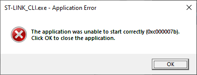

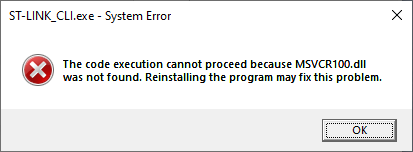

Pressed connect and get MSVCR100.dll MSVCP100.dll mfc100.dll not found ( Win 10)
0693W00000QMWvHQAX.pngBut I check path "C:\Windows\System32" dlls are exist
If copy dlls into folder and execute, get another error as below
0693W00000QMWvbQAH.pngStm32cubeprogrammer can work normal
