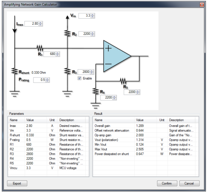

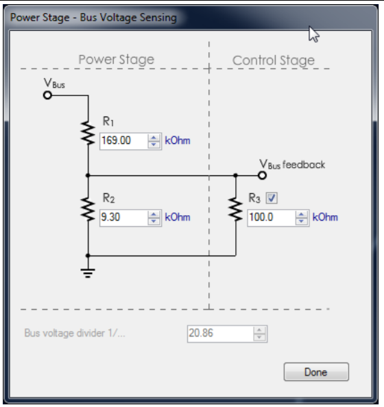

I am using NUCLEO-F303RE,
I have purchased a power board (IPM evaluation board EVALM13645ATOBO1) from Digikey.
  1. In the Motor control workbench, I didn't find above mentioned power board part no. so, can you tell me, which one I need to select in the drop-down list of power board custom board or else?
  2. In current sensing & Bus voltage sensing, the below-shown circuit value,
Is automatically calculated? or Is the user needs to configure this value?
If yes, where or how to find/check these values? 0693W00000DmMqMQAV.png0693W00000DmMqCQAV.png 3. is it possible to change the board details once it is selected.

Dear @Mathan Raja​
We are sorry but we only support ST power boards.
I don't know your board but I guess you can design your own based on a similar existing board.
Best regards
