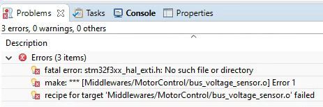

The toolchain from mcsdk -> CubeMX -> SW4 works perfect, but if I build the project, error messages appears !
HAL problems ect. I think libraries are missing. Can somebody help me please ?

stm32f3xx_hal_exti.h is part of STM32Cube Firmware Library. By default these files are installed in %USERNAME%/STM32Cube/Repository/ STM32Cube_FW_F*_V*, where the asterick is for the version of the firmware being used, for example, the latest is for STM32F3xyz is STM32Cube_FW_F3_V1.11.0. When you ran Workshop, it asked you whave version of the Firmware that you would be using and the project that it generated should have copied the files from the Repository to your project under the Drivers folder. I just ran a test case with SW4 and in the project folders is "Drivers/STM32Gxx_HAL_Driver/Inc" which includes the *.exti.h file in question. If the file isn't there for some reason, just put it there manually from the Firmware Repository files.
So you should check that you have the correct version of the firmware installed for your target processor AND
that the Workshop generated project has a path/link defined to this specific include folder. It should show up under "Drivers" in the Project Explorer. You can right click "properties" of the resource in the Project Explorer and it will show you the path to that resource.
Note: When you run code generator from Workshop, after it is complete if you click on the text on the screen it will open a log file with all of the test that provides a detailed description of what it was doing. Much of this is Java template generation, but the end of it includes the folder paths for the source and header files. This can be useful for debugging if you have to get into the details.

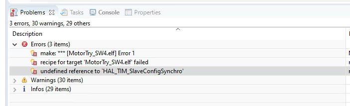

I have added the stm32f3xx_hal_exti.h & stm32f3xx_hal_exti.c , but these files i found in F1.11.0 directory and not in the F1.10.0 directory.
In MCSCK i use Firmware 1.10.0 ! And not 1.11.0.
again, new errors, and that is the point...
In the appendix the logfile.

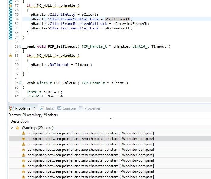

And if i try to build the generated SC with SW4 and Nucleo L476RG i get only pointer warnings, how can i fix it ?

You're having a bunch of compiler errors that you shouldn't be having. All I can suggest is to switch to another account or another computer and start again as it seems your installation is corrupted Or dump the Motor Control Workshop (MCW) altogether and start with one of the existing setups like SPN7 or SPN8, (search ST.com for these). You originally stated that you wanted to use Nucleo F303RE & IHM08M1. That's just the X-NUCLEO-IHM08M1 kit and you can use SPN8 code for that. Then you would not have to hassle with MCW code generation. You'd have to import that code into your IDE. I would suggest Atollic V9.2 as I've had better success with that than with CubeIDE (and the compile times are quicker).
I'm using the P-NUCLEO-IHM001 kit (F302R8 + IHM07M1) and the SPN7 for 6-step motor control as a starting point and I've been able to get that working using the Atollic V9.2 IDE. I was using MCW and I was able to compile some of that code, but the MCW generates code primarily for FOC and I'm more interested in 6-step motor control, so I stopped using it. The MCW is still a good place to look at the parameters for various things, driver boards and motors.

UPDATE: A other problem is the Avast Antivirus, too.
I delete it now !
after I formatted my PC "now with WIN 10" I only install CubeMX, SW4 and MCSDK, (now code generation works).
Yes in brackets.
According to ST, you should use the firmware F1.10 for Nucleo-F3 boards, but this causes the known errors.
But with the firmware F1.11 not, there are only pointer warnings, which you can ignore for now, usually not.
