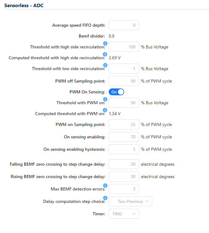

First, check the input signal of the BEMF for zero-crossing detection at ADC level after the resistors network. The input level must be in the range of 0 to 3.3 V. With VBUS at 48 V, use a divider to enable accurate VBUS/2 zero-crossing detection during the PWM-ON phase. Refer to chapter 3.2.5 BEMF sensing network in the user manual for STM32 Workbench, located at About/User Manual/Six-step firmware algorithm Documentation/html/md_docs_2six__step__firmware__algorithm.html.
If there is excessive noise, you may encounter difficulties with zero-crossing detection during the PWM-OFF phase.

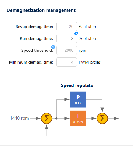

This behavior occurs after commutation and during the demagnetization phase. You can perhaps attenuate this behavior by changing the method used to compute the demagnetization delay. The demagnetization delay follows the speed information. At a certain speed threshold, the delay remains fixed. The STM32 Workbench and Motor Pilot tool allow you to change those parameters:
Into the STM32 Workbench:
  1. Decrease the Run Demag time percentage of the step when speed is below the Speed Threshold
  2. Decrease the speed Threshold to set only the Minimum demag. time (period)
  3. Decrease the Minimum demag. time (period)

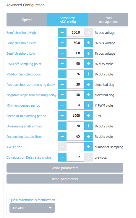

Into the STM32 Motor Pilot:
If the problem occurs during PWM-OFF zero-crossing detection, switch to PWM-ON zero crossing detection by changing the hysteresis value of the switch mechanism earlier. Change
"PWM on Sampling point" and "On sensing enabling".
