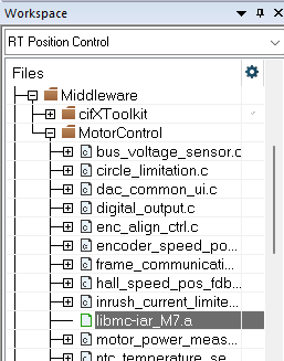

I am currently working on the steval-eth001v1 kit. If I open the project attached in the firmware, there is no problem. But when I want to create a new project using IAR or Keil C, an error appears that the c file is missing.
Anyone who has encountered the same problem can help me?
I can't find the c file containing the above functions in the new project, but when I run the project attached in the firmware, it doesn't report an error.

If your point is still pertinent, for IAR, RUC functions are embedded in libmc-iar_M7.a library. Make sure that this library located in "Middleware/MCSDK_v5.4.4/MotorControl/lib" directory is present on your project:
