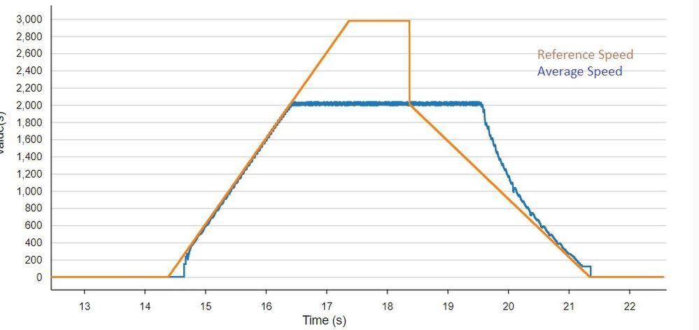

We are using MCSDK 5.Y.2 version.
We are getting average and reference speed with below functions.
average_speed = MC_GetMecSpeedAverageMotor1()*_RPM / SPEED_UNIT;
reference_speed = MC_GetMecSpeedReferenceMotor1()*_RPM / SPEED_UNIT;
We have a problem regarding that average speed following reference speed.
As we see, although we decrease the reference speed instantly, average speed decreases with a delay, didn't follow the reference speed. What may be the problem ?
By the way, firstly we increased reference speed over max speed of the motor as you can see from the picture.

‎2022-01-09 11:24 PM
The problem is inside the PID of the speed, the integral part. There isn't the anti-windup in case the PID of current can't set the output of the PID of speed. A possible case is low bus voltage.
