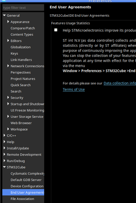

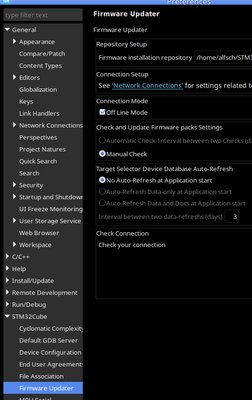

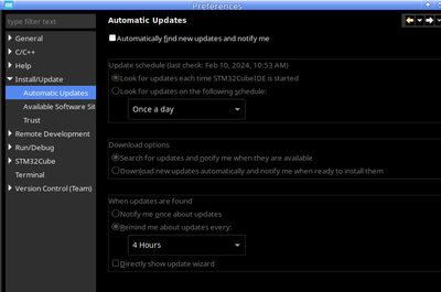

>since STM32CubeIDE auto-updates frequently
no - if you stop this, no update. (in Window-> Preferences )
+ disable the "login" feature.
-> Try. As long, as you dont need new version, for new cpu or features, you can "fix" it to actual state.
