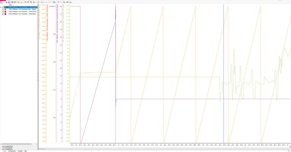

I'm working on a project whith use a STM32F407 MCU to control a bldc motor and also has a low power mode, the mcu will into stop mode.
Now the stop mode is working, and we have issue to control the motor after wake up from stop mode.
the code to entere and exit the stop mode

Also we tried to send the motor speed and status to the CAN bus, below is the code

What we notice is that after the wake up from stop mode, the motor status somehow seems normal, but it will take about 2 seconds to start the motor, you can ref to below picture,
The motor status change from, 16-18-4-6, and after the status changed to 6, it takes about 2 seconds to start the motor, and in normal status, means we do not have the wakeup, it takes about less 100ms to start the motor.
Not sure why it takes so long to start the motor, and as we want to evalute the response time of this low power mode, this 2 seconds is somehow critical for us.
Appreciate for your comments, thanks.
