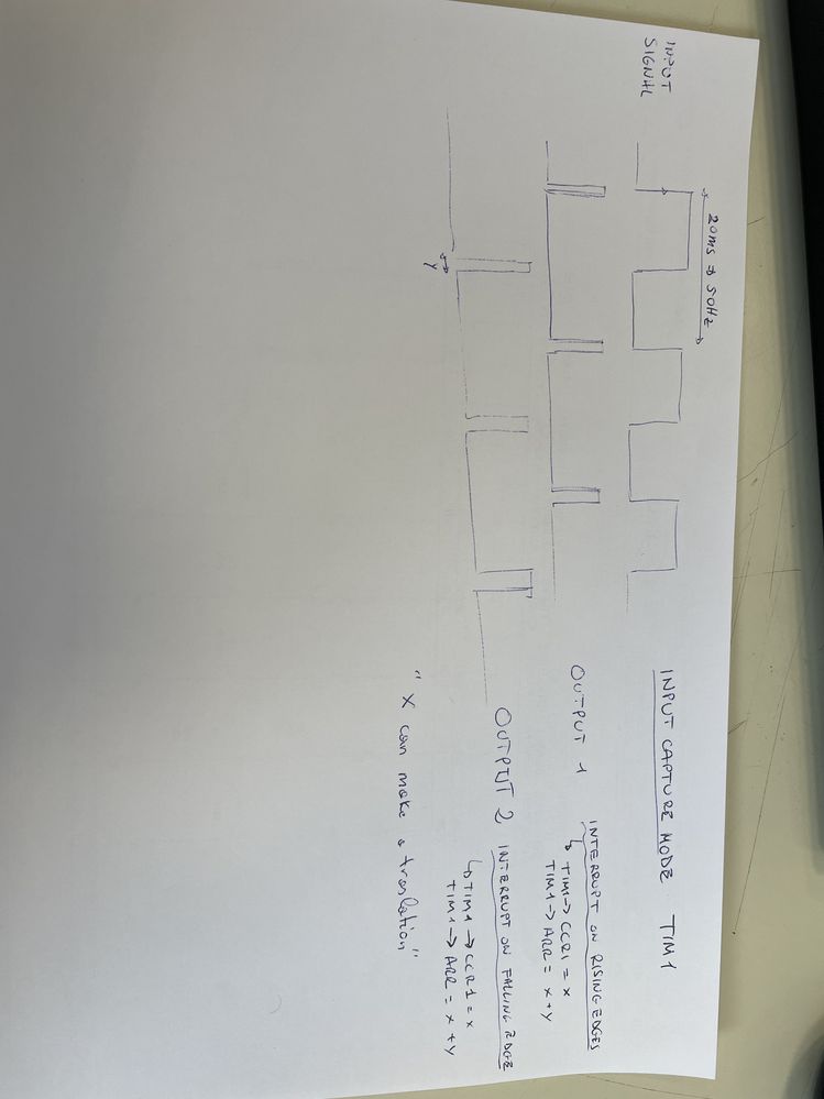

i have an external signal , this is a square wave of 20 ms of period. i will put this signal on input capture channel of the timer.
i want to generate interrupts on rising and falling edge of input capture , but i want to do it in separate or differently output as the photo 0693W00000NpMB0QAN.jpg

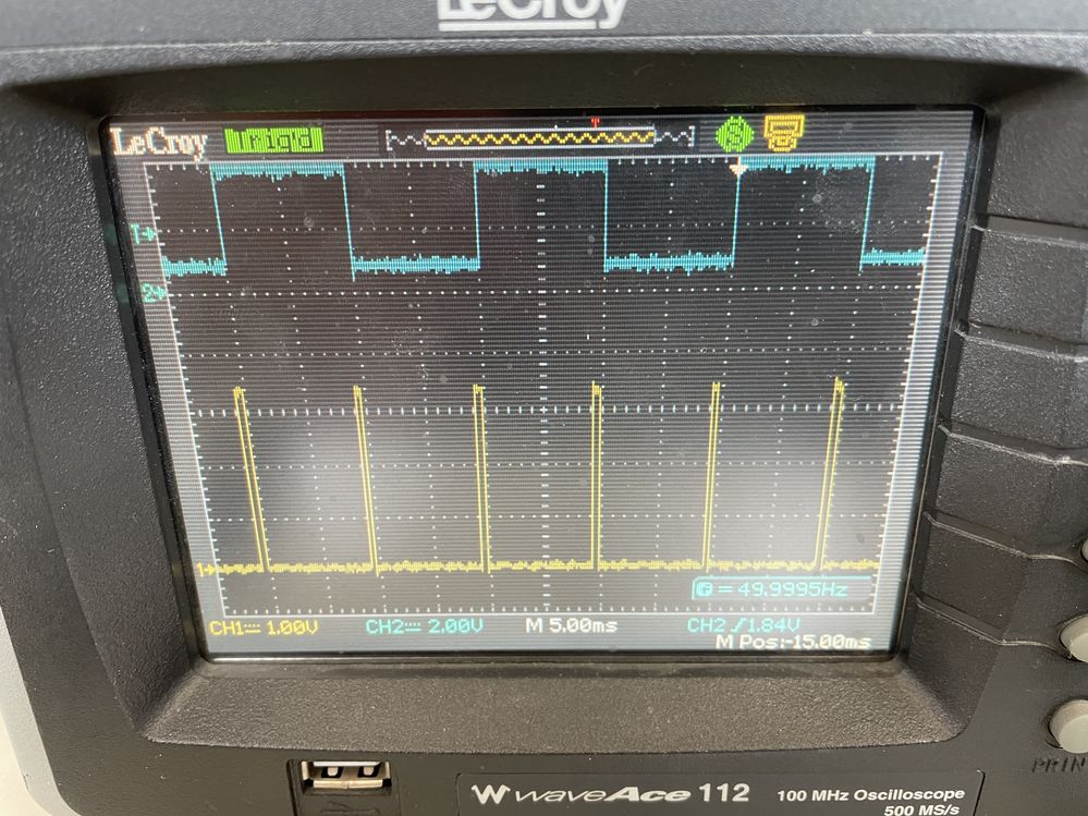

at the moment with this code i have only one output and the pulses are 10ms of period but i want two differently output like the first photo

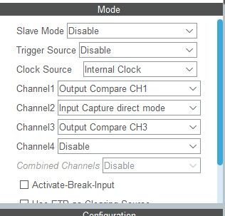

i am using this configuration. Should have 2 outputs and 1 input signal that is an external square wave0693W00000NpMuKQAV.jpg
