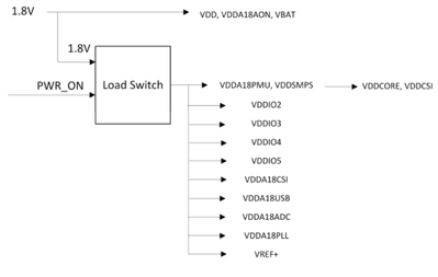

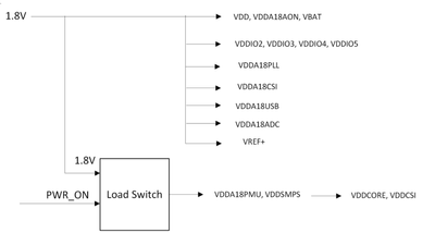

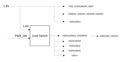

In our custom board design, we are using only one regulator to generate 1.8V.
Could you please suggest us which power tree will be suitable to manage power up sequence?
Option-1
Option-2
Option-3

Option 2 is a suitable choice for your board architecture. It keeps VDDIO and VDDA1V8_AON powered first, so the MCU always-on domains are available before the other supplies.
Then, depending on your regulator arrangement, assert PWR_ON to enable the SMPS path and generate VDDCORE.
After that, you can power the remaining supplies, such as: VDDA1V8 VDDA18USB VDDA18CSI ..

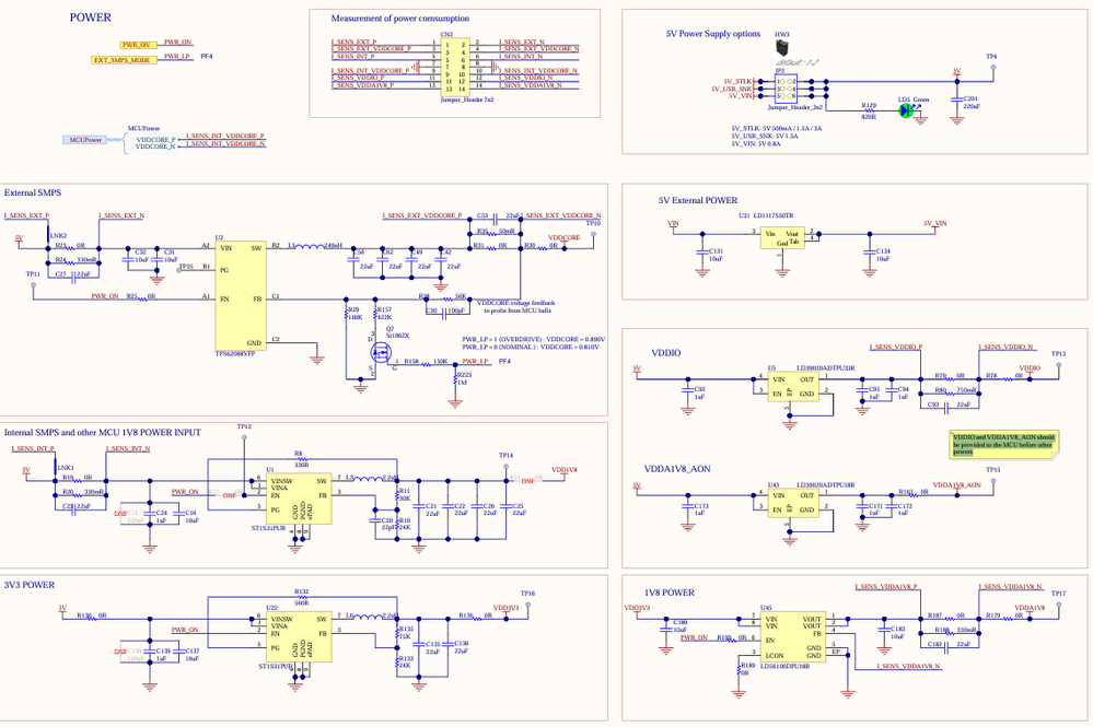

You can refer to board schematics as reference.
