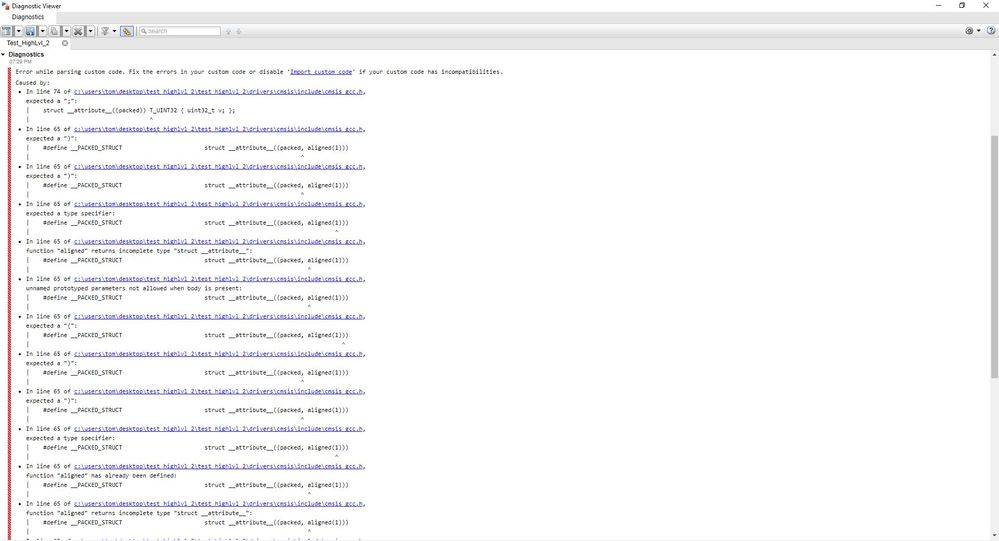

At this moment i am able to include the necessary .c and .h files, but cannot build the code.
I uploaded the occuring error.
Thanks for your help.

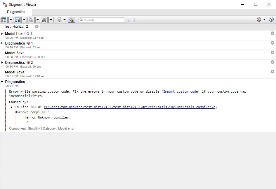

To my knowledge, these libraries are designed to work very tightly with the various Timers, which have to be configured in a certain way. Did you configure all the timers and the IO for the communication in the model? I cannot see from the screenshots if you did. Moreover, these libraries may also set up a few MACROs, one of which is the target, which leads you to the error message you get. You may have to define the macro STM32F446RE somewhere in your MATLAB project, such that it can resolve the inclusiong of the right header file within Simulink, before even getting to the generated project, where these macros would be defined.
‎2020-06-22 9:36 AM
Thank you for replying.
i've already tried to define those macros in matlab.
This works just fine until the error message shown in the following screenshot.
No i haven't configured any IO's or timers since i wanted to see if i'm able to generate the code from simulink at first.
Is there perhaps any way to deactivate those macros?
‎2020-06-22 10:04 AM
It certainly has something to do with the fact that Simulink does parse the code in the absence of a full project in an IDE. The first of the error messages, caused by stm32f4xx.h in line 175 was because there was no target MCU defined, which leads to an error. The latest error is caused by the same issue, but this time with the issue of the target compiler not being defined.
For the first error code needs to define the macro STM32F446xx in order to parse correctly, and in the second case the macro associated with the compiler you use.
I would personally have a look at the header file dependency in the libraries from ST, identify the highest level header, i.e. the header file that is included in all the other files, and change it to add
#define STM32F446xx /* file st32f4xx.h line 157 now parsed*/
#define __GNUC__ /* or whatever tollchain you plan to use */
That should add the required information to parse the files correctly, and if they match what the toolchain would do there would be no issues.
‎2020-06-22 10:34 AM
Found a fitting .h file which seems to solve the second error.
Now i'm getting this one.
(sorry i'm not familiar with c code)
Btw: I'm using SW4STM32 as my toolchain.
‎2020-06-22 10:48 AM
I am afraid that you may have run into C code which uses C language extensions not recognised by Simulink. It says in the begining of the second screenshot—which may actually be the first—that you have an option to disable "Import Custom Code", which may be defined precisely for this reason. Might be worth a try.

‎2020-10-14 9:11 AM
Dear @tired​
Did you checked your .h header calls tree?
According to your error logs, I am not sure than "packed" and /or"T_INT32" are recognized where used for the first time.
Best regards
Laurent Ca...
