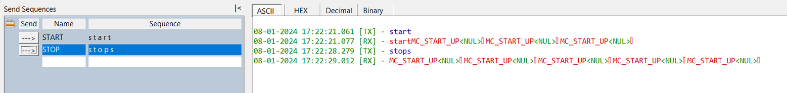

Getting speed feedback and start up error whenever i start the motor
soundarya_h_s
I am using 24V, 2.0A, 3000RPM and 2 pairs of poles BLDC motor. When ever i start the motor, motor is run far 3 sec and it fetch speed feedback and start up error.
Below i provided the code:

Below i provided output screen:
can anyone with any suggestion or any input why i am getting this error?

soundarya_h_s
hi @cedric H
I am using STM32G474RE board, uisng motor control workbench 6.1.2 and I have checked motor with motor profiler.
I want to know that why i am getting this fault errors.
Also can you tell me how to resolve this error
