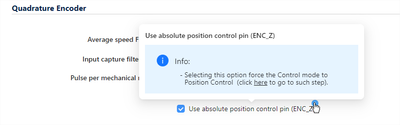

Hey,
when I use the EVSPIN32G4 without speed measurement the motor rotates normally. But if I use the encoder for speed sensoring the motor just vibrates.
Motor: 4221g048bxth
Encoder: ie3-1024
Does anybody know how I can solve this problem?

    Could you please check that U, V, W motor phases are correctly connected to the board? A, B, I(Z) from the encoder also?
    For the encoder, you could also check that A, B, I signals are correctly toggling on board side spinning the motor by hand.
    If you agree with the answer, please accept it by clicking on 'Accept as solution'.Best regards.GMA

    Hey,
    thanks for your answer. I made some tests and realized, that everything is working fine, if I dont activate the I(Z) Channel, meaning absolute position control. If I activate absolute position control in the MCSDK, the motor just vibrates and doesnt move. Do you know how to solve this issue?
    Could it be because of the Position Regulator? Because when I activiate the absolute position control (meaning the I(Z) Channel) the Position Regulator becomes a PID-Regulator instead of a PI-Regulator.
    Thanks

    As mentioned in "Speed Sensing Config", selecting "Use absolute position control pin" will set the control mode to "position control mode". Then, you have to use motor pilot with Position Control GUI
    If it is already the case, could you please check that the Z signal is correctly generated by the motor?
