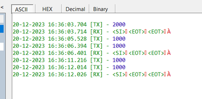

Problem in passing the commands "start" "stop" and rpm as "1000" through UART
soundarya_h_s
Sharing the snippets of code related to UART from code generated using motor profiler, motor pilot and stmcube ide

OUTPUT I AM
RECEIVING:
Please help me to rectify this error

> uint16_t rxbuffer[5] = {0};
Should almost certainly be uint8_t, not uint16_t.
Debug the code, set a breakpoint and examine the contents of rxbuffer when HAL_UART_RxCpltCallback is called.
Bit of a mess.
Couple of thing that would be better as subroutines.
Don't call long blocking functions in interrupt / callback context.
Review why the echo back gives nonsense. ie wrong baud rates, clocks, or RS232 vs CMOS levels.
Ponder how you might recover or resync the stream if it shifts.
