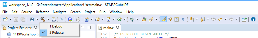

​Hello David,
If you look at the image below, you will see a contextual menu allowing you to choose between Debug or Release mode.
The correct optimization level is set in Release mode.
This menu is accessible through the little arrow at the right of the hammer.
Let me know if it fixes your issue.

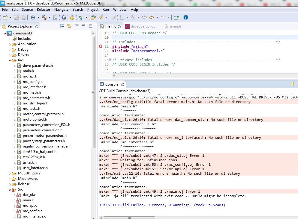

I am careful to put my code inside those comments where required, though I sometimes miss it since the open and close comments are in odd places - e.g. wrapping the main function and main closing bracket, but not including the empty space in main - but this is not the explanation. I have experienced the CUBEMX overwriting the .cfg and the FLASH.id files when regenerating, which results in a program that won't build or flash. I use source control, so was able to find this fairly easily. This may have been fixed in a later release, I haven't experienced it for a month or so.
My MCSDK was 5.4.1, not 5.4.2, I'll try updating. Would be nice if it informed of new releases, or am I missing something? HAL level was correct though, and CUBEMX version was the same as released with CUBEIDE, which is no immediately clear as to what release it is, the only place I seem to be able to find the release number of the bundled CUBEMX is when I generate a project report, which says 5.4.0.
-------------30 minute time break updating everything and re-creating all the codes etc.---------

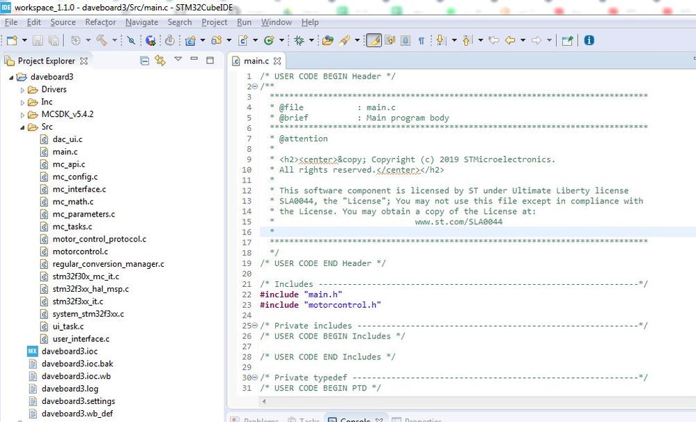

I now have the latest of everything, have meticulously followed the process MCSDK, CUBEMX, CUBEIDE generating a new project into a new blank folder in my "mydocuments" and can report...
It couldn't import the project still, and has the can't build hammer greyed out error. If I try to import it, it doesn't recognise the project atall, and if I click the .project file, it opens in CUBEIDE but can't build. Come on guys... This is getting silly. Can still import a TrueStudio project in the same way and it works. This is your flagship software, and it can't recognise its own generated code.
STM32CubeIDE
Version: 1.1.0
Build: 4551_20191014-1140 (UTC)
STM32CubeIDE
Version: 1.1.0
So restarting CUBEIDE, adding an arbitrary GPIO and regenerating made the hammer appear.
But now it can't build because it can't find main.h and a load of other arbitrary yet important things that are clearly there...
