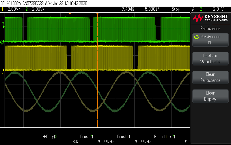

Hi, i am trying to control bldc motor sinusoidally. I completed with 6 step commutation.
I asked help in stm32 forum recent, but none helped. I have learned something in sinusoidal bldc control.
  • FIrstly i implemented spwm using sine LUT (say 256 vales)
  • And i spwm give good looking sine wave.
  • I also generated 3 sin waves phase shifted 120 each.0690X00000BxSENQA3.png
  • So now i have 6 spwm (3 sine 120 phase shifted & 3 sine complemented)
  • Now i run the motor using this spwm (open loop sin control), the motor runs but consume more than 10amp.
I don't know where i am wrong, guys help me to solve this problem.

The required current (sine amplitude) should be dependent on the required torque and speed.
https://www.celeramotion.com/applimotion/support/technical-papers/sinusoidal-drive-operation-with-brushless-pm-motors/
Bud
THank you for your response . Ok piranha what you are saying is, running bldc motor under open loop sinusoidal configuration is accurate and will consume more current. Now i will try to synchronize the hall sensor data (RPM) with sin table. Can you give some advice for this.
