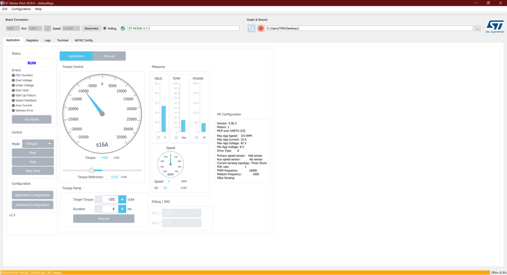

Hi, I am using board B-G431B-ESC1 and Motor Control 5.Y.3.
When controlling the motor through the Motor Pilot and increasing the current, I get a recurring Bad CRC Header error.
There is a neighboring forum thread where this is discussed
And there was a proposal to reduce the speed of USART, but this did not lead to anything for me, I tried it at speeds of 115200 and 1843200.
If the motor is standing or moving without load, everything is fine, but as soon as the current increases and reaches, for example, 5000 units of s16A, then this error begins to appear.

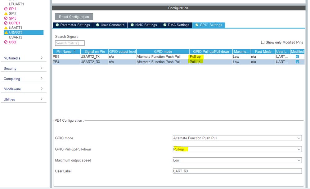

Could you try to configure UART pin internal pull-up as shown in the picture attached ?
