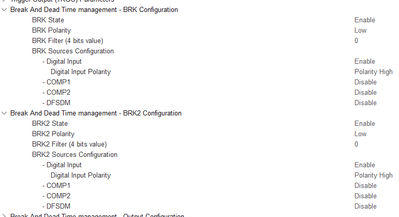

The BK1 and BK2 is setup in the Timer1 with correct polarity etc.

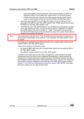

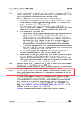

Essentially the same note applies:
So the question is, is the break source persistent? If yes, disable break interrupt in TIMx_DIER and reenable it only after the break source has been cleared.
