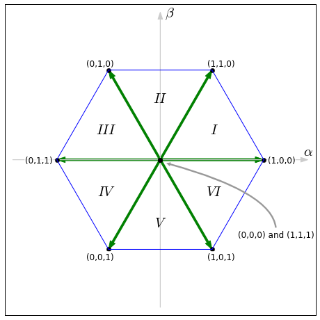

I have come across the definition of "DC Vector" when looking for information.

Could you give me some link for "DC vector"?

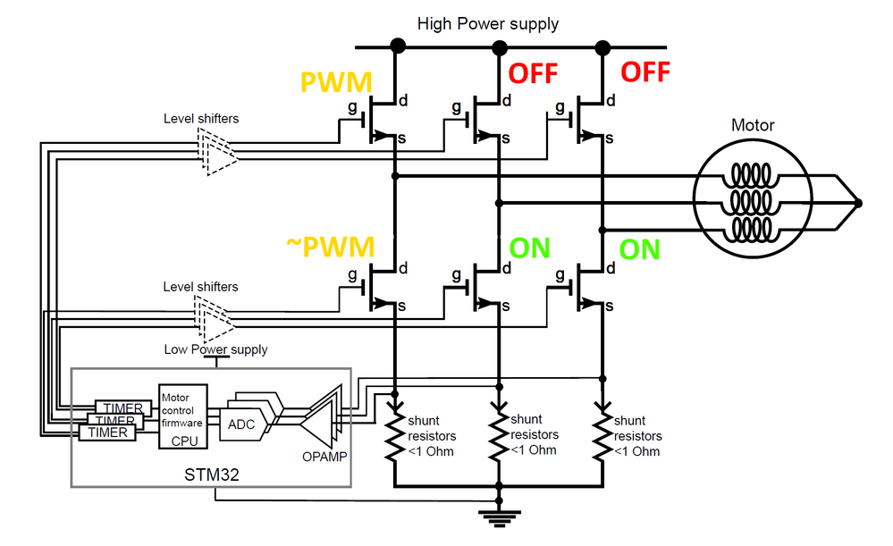

In general, I solved my problem. The idea is to turn on the PWM on one phase then the PWM will control the blocking torque.
I just did it manually via HAL functions, I hope it won't lead to problems when returning to control via the Motor Control library.
If someone knows a more beautiful and correct way to do this, please write here.
MC_StopMotor1();
HAL_TIM_PWM_Start(&htim1, TIM_CHANNEL_1);
HAL_TIMEx_PWMN_Start(&htim1, TIM_CHANNEL_1);
TIM1->CCR1 = 500;

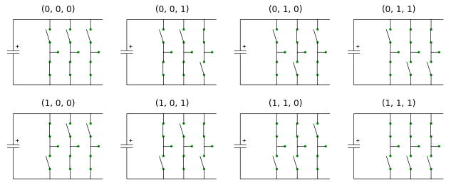

Shorting all three LOW or HIGH side mosfets will short the induced current in the motor to fixed potential ground/vcc.
This gives you a better braking strength when stopped or low speeds indeed. (when the EMC fields built in iside the coils doesnt need to colapse because there is no EMC built in yet)
Im not familiar with the st control api but if you find something like setFOCstep( stepNumber)
You would want to set it to setFOCstep(7)
or (1,1,1)
0693W00000HoLv6QAF.png0693W00000HoLvGQAV.pnghttps://microchipdeveloper.com/mct5001:space-vector-modulation

Thanks for your reply! Yes, turning on all the lower transistors is what I have already considered. It turns out to be a good idea for dynamic braking at low speed, when regenerative braking can no longer work, but no braking torque is generated at zero speed. That is, in essence, the braking torque in this method is a function of the rotational speed. The faster we are to crank, the more difficult it becomes. If turn the rotor slowly, there will be almost no resistance.
This method is essentially a special case of mine when the PWM duty cycle of the first phase is equal to 0 and we get the first small braking torque,
TIM1->CCR1 = 0;
then increasing the PWM braking torque increases.
TIM1->CCR1 = 500;
