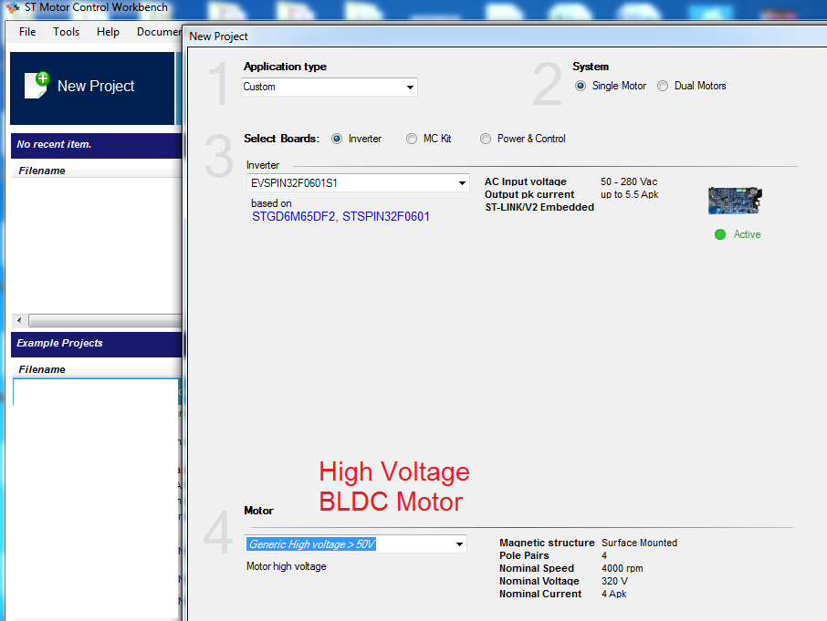

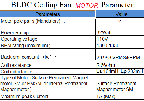

I have to make low cost on BLDC Drive for BLDC Ceiling Fan ( 110V ) without any sensors.
This topic is continuation from below thread as below thread don't pay much attention there as required :
https://community.st.com/s/question/0D73W000000Uy06/detail?s1oid=00Db0000000YtG6&s1nid=0DB0X000000DYbd&emkind=chatterCommentNotification&s1uid=0050X000007vw7K&emtm=1602748687452&fromEmail=1&s1ext=0
Below are parameters which I have:
I have download below softwares :
https://www.st.com/content/st_com/en/products/embedded-software/mcu-mpu-embedded-software/stm32-embedded-software/stm32cube-expansion-packages/x-cube-mcsdk.html
And seen below Eval-Board .
https://www.st.com/en/evaluation-tools/evspin32f0601s1.html
Please suggest . . .
How do I start ?
Many of Thanks in advance ..
Karan

so you have the EVSPIN32F0601S1eval board with you?
Maybe you can show us your wiring in case nothing is blinking or you dont know where to start

Meanwhile, I am trying to learn MC-SDK for EVSPIN32F0601S1eval according to motor specifications given at Msg#1.

Thanks for update ... Means you have successfully Implemented BLDC HV Drive ?
1)
When I have EVSPIN32F0601S1eval board with me do I need only Enter Motor Parameters as in Msg#1 in mcsdk to spin the Motor ?
2)
Do I need to change Feedback resistance(s) in Board EVSPIN32F0601S1eval board .
What kind of other changes in mcsdk ..?
Any other suggestions..
Karan
Please update. ​
@Community member​  if you dont tag me i dont get the notification (dont know why)
1) no idea, you should first run the motor profiler tool to get your parameters.
2) i dont know the board and i dont know what feedback resistors youre refering to.
Available for consulting/freelancing , hit me up in https://github.com/javiBajoCero
@Javier (Community Member)
 EVSPIN32F0601S1 or S3 is not supported my Motor profiler Tool Yet
