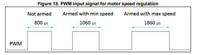

The electronic speed control (ESC) feature allows to control the motor speed with a PWM signal in input, for example on the B-G431B-ESC1 boards it is possible to use this feature to control the motors of a drone sending a PWM signal with a different duty cycle to switch the motor to armed, armed with a minimum speed, armed with a maximum speed and unarmed state.
You can find more details on this example on this link : click here
on the chapter "Connection and first execution of the electronic  speed controller (ESC) program".

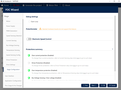

To use this feature with the MCSDK, you can activate the ESC part on the Workbench from the "Stage configuration" tab :
