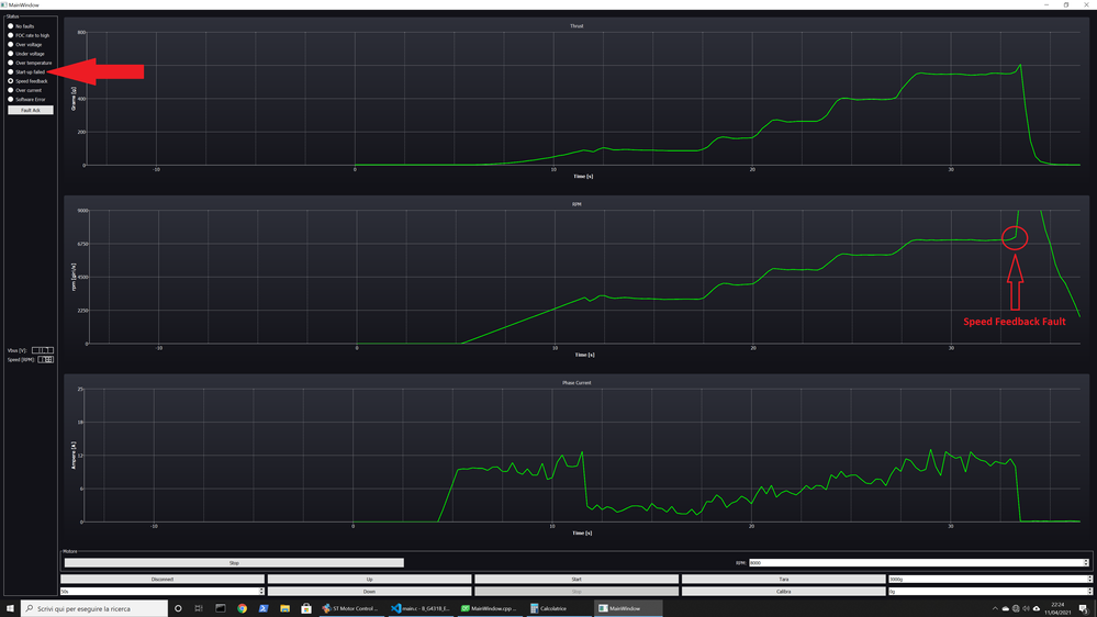

I am trying to get a BR2804-1700 kV motor running utilizing a B-G431B-ESC1 board. Till now I managed to get the motor starting to rev-up, but in the middle/at the end of the rev-up process I receive a "speed feedback"-error in the Motor Control Dashboard. Running the motor from Motor Profiler works without any problem.

I was able to solve the described problem. Instead of decreasing the PWM frequency I had to increase the execution rate of the regulator, which automatically adapted the control parameters. I guess it would have also worked if I were able to adapt the parameters by myself in similar way.

I tryed to increase the execution rate from 1 to 2 for the flux and torque regulator, but then my motor fault at the beginning
of the startup phase.
The strange thing is that if I spin my motor without propeller I can reach 9000rpm before a "speed feedback" fault,
instead when spin the same motor with propeller I can only reach 7000rpm before a "speed feedback fault.
I don't understand why the same fault at different rpm.
