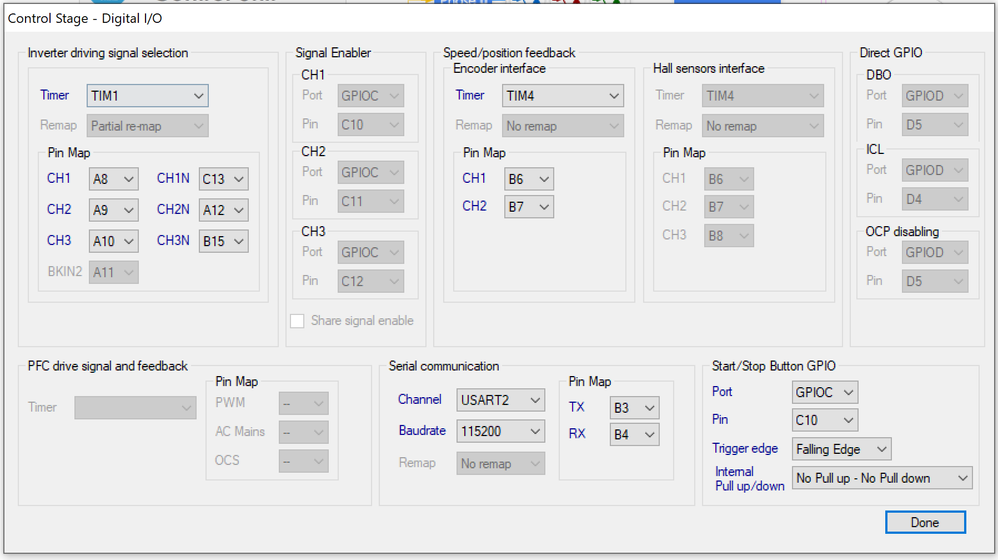

UNK  09:07:29        A0 is used in: Encoder Interface Timer( TIM2 ).CH1, Bus Voltage feedback ADC( ADC1 ).ADC12_IN1
UNK  09:07:29        A1 is used in: Encoder Interface Timer( TIM2 ).CH2, Phase current feedback OPAMP( OP1/OP2/OP3 ).ChU NoInv

erno.1
Motor control workbench -> Digital I/O -> Encoder interface -> Timer= TIM4 CH1=B6 CH2=B7

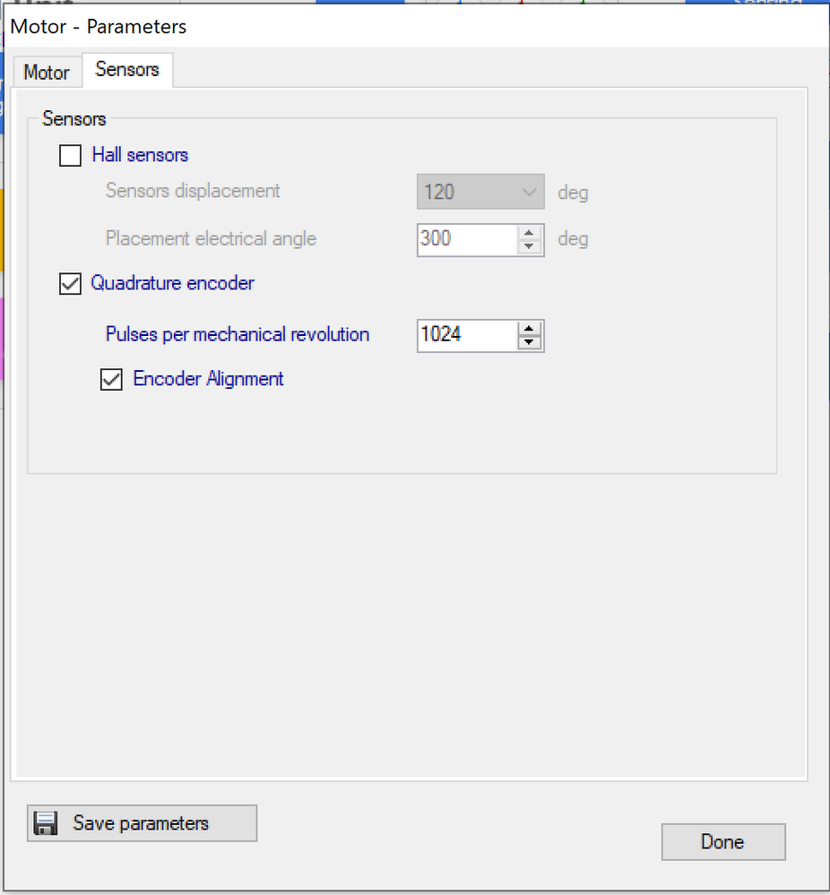

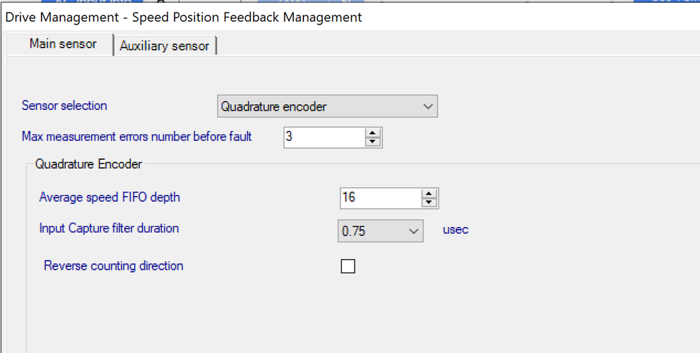

I am having a Similar problem and I hope someone could help as I don't even know how to debug my issue.
I have taken all the steps above and I'm trying to run speed control loop but as I try to do speed control with quadrature encoder rather than sensor-less mode, the motor doesn't turn. it makes some constant noise and it doesn't move at all.

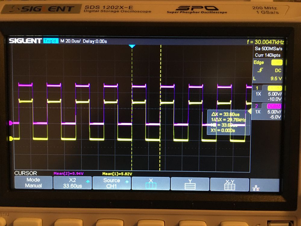

the same experiment works if I change the speed sensing block's properties to sensor-less but if I choose quadrature encoder it just makes some noise and no motion. I have tested the encoder and all signals look correct on the scope. When I turn the motor by hand I can see under "Measured Speed" that it is being measured correctly.
Here are some screenshots of my settings
0693W00000BbkbzQAB.png0693W00000BbkbuQAB.png0693W00000BbkbpQAB.png0693W00000BbkbkQAB.pngAny advice is greatly appreciated.
erno.1
Have you tried to switch encoder A and B wires?
Encoder rotation direction should match motor rotation direction.
I have, In fact even if I remove the encoder wires the behavior is the same, which is very strange.

One major question for me is how does this hole pipeline find out the alignment between encoder and stator? I initially thought "Encoder Align" button would do it (maybe by using the estimator internally to find the alignment?) but pressing that applies some voltage to the motor for like 1 second and stops (it doesn't move the shaft at all). Also the Z signal from the encoder doesn't seem to be used in the ControlWorkbench/generated code(this is another thing I would have thought is necessary for alignment.)
