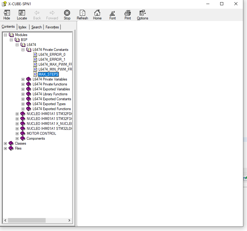

The compiled help files like X-CUBE-SPN1-HELP.chm does not work right.
I can see the contents, but no text under the contents. Please just give a .pdf of the detailed information and screw the help file.
