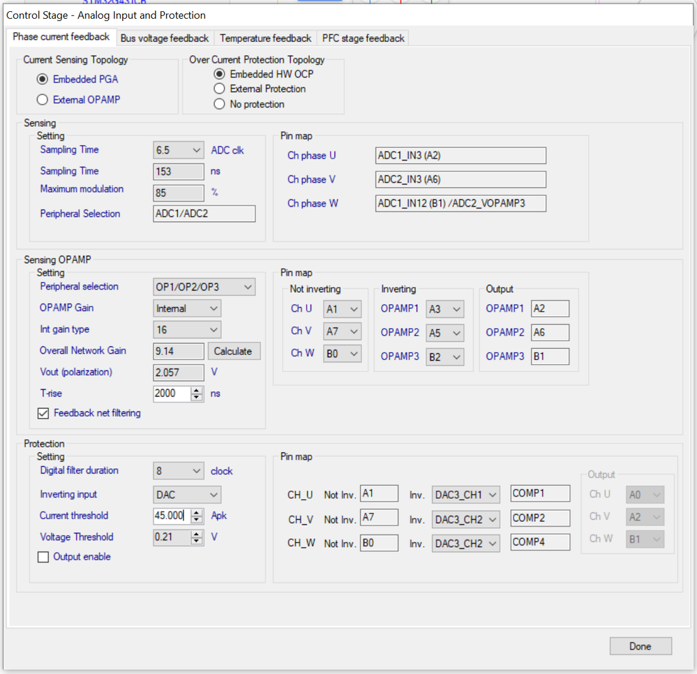

it's seem we have almost the same problems. When we try to reach full rpm we get an overcurrent fault, the motor brutally stop and consequently we get a speed feedback fault. I verified I have both fault at same time with the function MC_GetOccurredFaultsMotor1().
Yesterday night I tryed to increase the current threshold from 45 Apk to 120 Apk and higher and that solved my problems. Now I can reach almost full speed without any fault. Phase currents stay always under 18 A so I think to be safe. It's not so elegant but for now seem to work.
