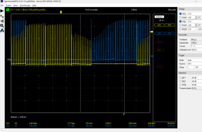

Working, right before 2KRPM

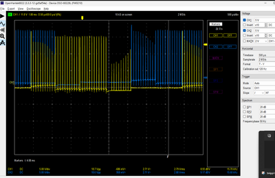

Squeeling starts, right around 2KRPM:

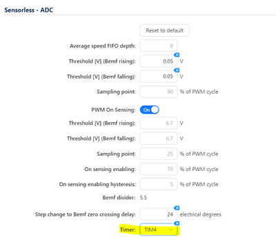

    3. To avoid the conflict between MCU resources, select a different timer for the speed controller in the workbench (tab "Speed sensing config", for instance TIM4)

    - In the image, the yellow curve looks weird: the baseline is negative. Is it an acquisition issue?
    I don't think so, I am using a working oscilloscope, and the signal looks perectly normal right before 2Khz, (the first image).
    I just know that the trapezoidal waveform looks much different immediately when the problem threshold RPM (~2K) is hit. I've never seen anything like this on other platforms I've implemented 6-step BLDC commutation on

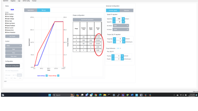

    2. The circled are in the picture above has strange values which I don't udnerstnad the meaning of. . Where can I get most up to date documentaiton on all of these parameters? (I find the format of the PID controller values very confusing)
    3. When I try to enable the ESC PWM control input, I get an error for re-allocation of TIM2 on the build. What is TIM2 used for in this app and can another timer be used instead (ESC PWM detection seems can only use TIM2, which makes sense since there's a hardware connection there)
