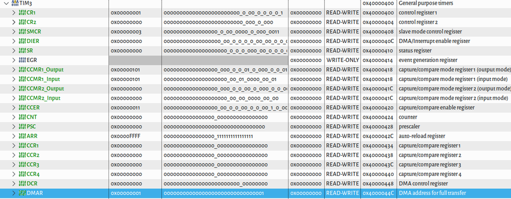

Remove the code related to index. Still no work? Read out and check/post TIM and relevant GPIO registers content.
‎2020-06-30 11:09 AM
@Community member​ Thanks, removing the index code doesn't unfortunately.
Viewing at the registers, I noticed that the SR update bit was set, so I reset it before timer start. No difference. Here is the full register dump:
‎2020-06-30 11:23 AM
Looks good.
Now the relevant GPIO registers' content?
‎2020-06-30 11:25 AM
Wait.
PD2 and PD7? They don't connect to TIM3_CH1 and TIM3_CH2. See Alternate function mapping table in the datasheet.
