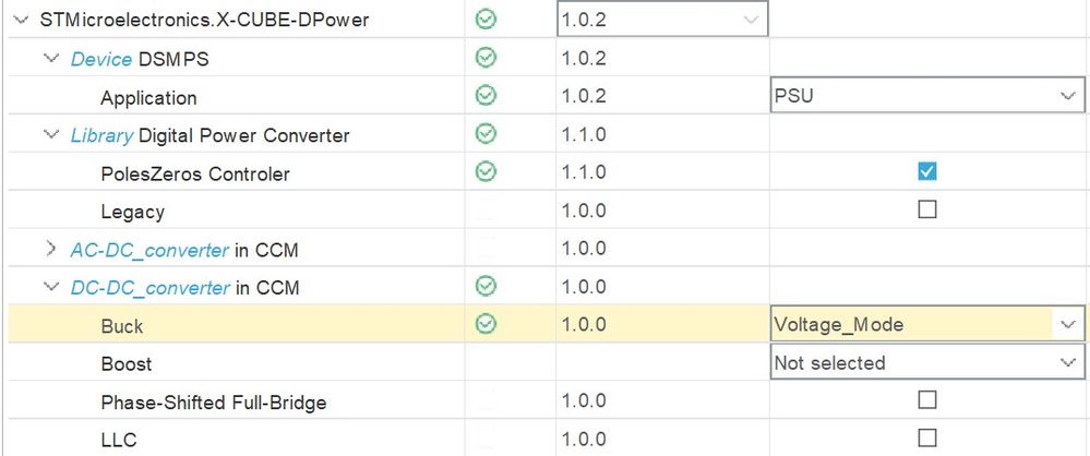

At this point I have downloaded and installed the X-CUBE-DPOWER software pack ver. 1.0.2 from ST repository.
I have made the selection as in the following imagine:
0693W00000YAWL2QAP.jpgNOTE: Only X-CUBE-DPOWER is 1.0.2 but the components of the software pack are 1.0.1 or 1.0.0.
0693W00000YAWL7QAP.jpgAfter the selection I click on the button Device Configuration Tool Code Generation and all is ok.

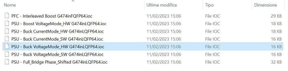

I have selected the button Start new project form STM32CubeMX file (.ioc)
Then I have selected the file PSU - Buck VoltageMode_HW G474inLQFP64.ioc
The file is at the following path:
C:\Users\user1\STM32Cube\Repository\Packs\STMicroelectronics\X-CUBE-DPower\1.0.2\CubeMX Files References\

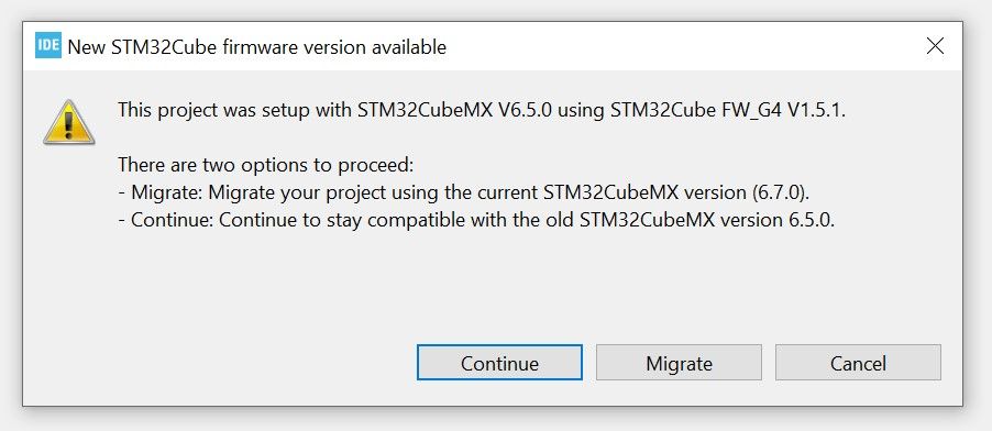

During the import of the ioc file I receive the following message:
Then I select to migrate.

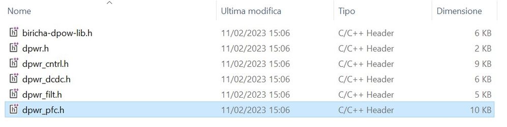

../DPower/App/DCDC_Fault_Processing.c:32:10: fatal error: dpwr_pfc.h: No such file or directory
  32 | #include "dpwr_pfc.h"

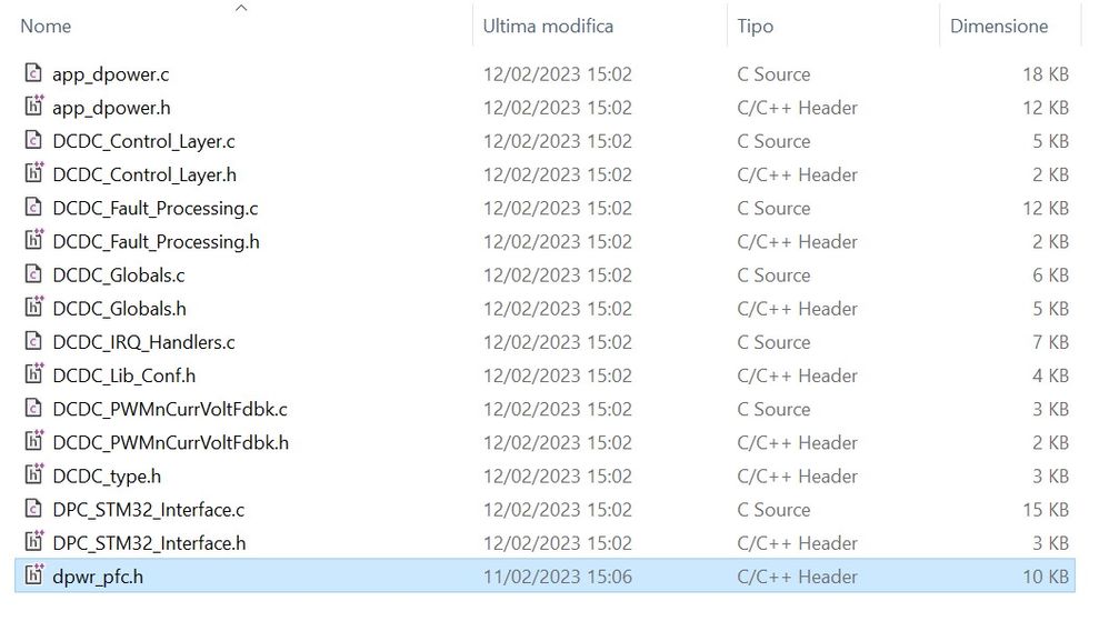

I have found the file at the following path:
C:\Users\user1\STM32Cube\Repository\Packs\STMicroelectronics\X-CUBE-DPower\1.0.2\Middlewares\ST\Third_Party\Biricha\Inc\
0693W00000YAXGSQA5.jpgI have copied the file at this path of my project:
C:\STMicroelectronics\Projects\PSU - Buck VoltageMode_HW G474inLQFP64\DPower\App\
After this I compile the project with success.
