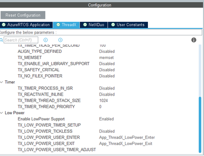

I configured ThreadX for low power:
And implemented the following functions:
  * @brief  App_ThreadX_LowPower_Enter
  * @PAram  None
  * @retval None
void App_ThreadX_LowPower_Enter(void)
  /* USER CODE BEGIN  App_ThreadX_LowPower_Enter */
	  ULONG currentValue = 0;
	  UINT ret;
	  tx_semaphore_info_get(&mainSemaphore, NULL, &currentValue, NULL, NULL, NULL);
	  ret = tx_semaphore_get(&mainSemaphore, TX_NO_WAIT);
	  if (ret == TX_SUCCESS)
	    HAL_GPIO_WritePin(SWITCH_GPIO_Port, SWITCH_Pin, GPIO_PIN_RESET);
	    printf("go to sleep\r\n");
	    /* Enter to the stop mode */
	    HAL_RTCEx_SetWakeUpTimer_IT(&hrtc, 60, RTC_WAKEUPCLOCK_CK_SPRE_16BITS);
	    HAL_PWREx_EnterSTOP2Mode(PWR_STOPENTRY_WFI);
  /* USER CODE END  App_ThreadX_LowPower_Enter */

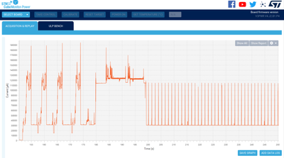

But still the board does not seem to go to sleep.
I use the StLink-V3-PWR and am measuring this current draw from startup to "sleep".
Any help or ideas would be greatly aprreciated.
